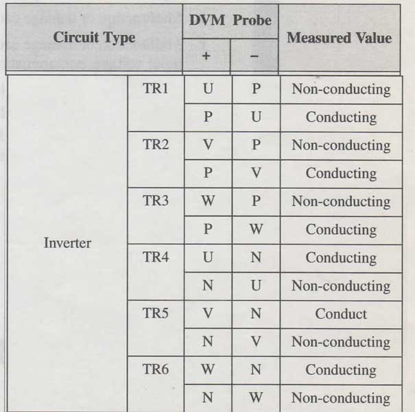

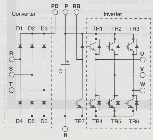

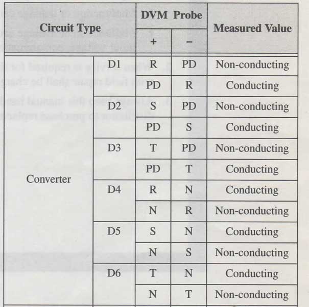

Here is the lGBT test method as it appeared in an older Hitachi drive manual... This is a great way to pinpoint the source of drive/motor issues.
The following procedure will check the inverter transistors (IGBTs) and diodes:
1. Disconnect input power to terminals [R, S, and T] and motor terminals [U, V, and W].
2. Disconnect any wires from terminals [P] and [RB] for regenerative braking.
3. Use a Digital Volt Meter (Multi-meter) and set it for 1 ohm resistance range. You can check the status of the charging state of terminals [R, S, T, U, V, W, RB, P, and N] of the inverter and the probe of the voltmeter by measuring the charging state.
If resulting reading is almost infinite ohms = "non-conducting," and readings from 0 to 10 ohms = "conducting."
NOTE 1: The resistance values for the diodes or the transistors will not be exactly the same, but they will be close. If you find a significance difference, a problem may exist.
NOTE 2: Before measuring the voltage between [P] and [N] with the DC current range, confirm that the smoothing capacitor is discharged fully, then execute the tests.
Good luck and Happy IGBT'ing
best regards,
Action Jack

Thanks for the IGBT troubleshooting guide, I was able to perform this test with no experience. The IGBT that I thought was bad, actually wasn't so I moved on. Easier than I thought...
