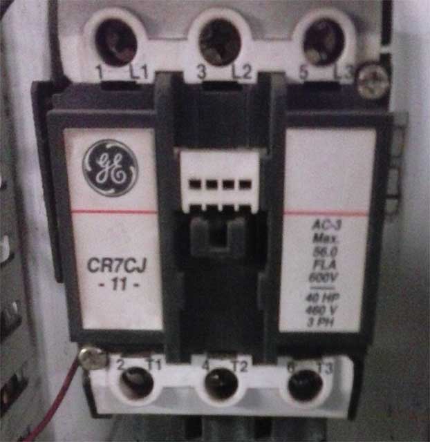

OK, just one more question, how low can the field current go before the field weakening before the contactor should open the circuit? If I've got a 7.75A field current on the nameplate, where should i set the adjustment on the contactor?
The field weakening adjustment on this contactor is by done with a set screw. The clouds are lifting now!
